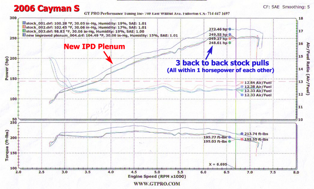

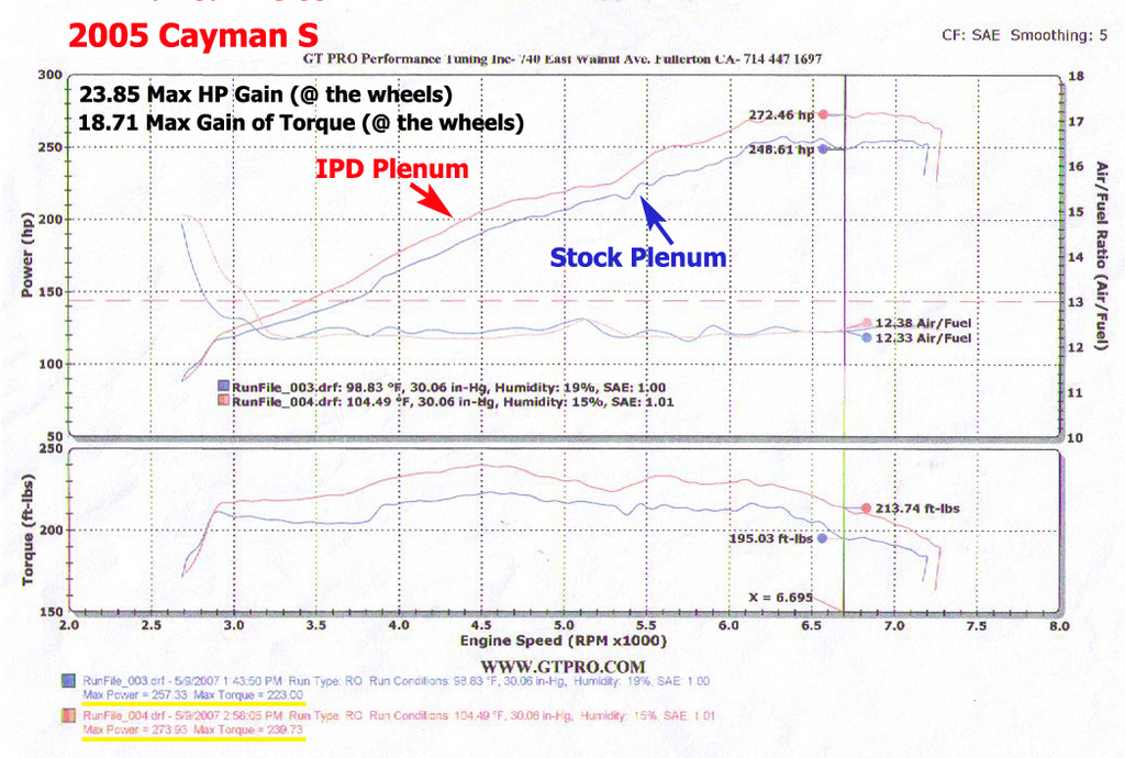

Actually there were several dyno runs done on the 996 side of 6speedonline with the 3.6L, I saw 7-8rwhp at peak hp and 10 ft/lbs of tq at peak. At the delta there was a 20rwhp gain but only for 300-400rpm. I actually did a search for this last night on 6speedonline and found it. Do a search on the 996 board of 6speed you will find it.

In a recent issue of European Car they got 10-11Hp on a dyno and approx 15-18 Ft lb of torque going from Memory. Try one your Butt might like it if you get it off your head. :D :D

Do you know what sarcasm is? Read the whole post. The “those stupid Germans” comment was a sarcastic comment meaning that if the builders of the best engineered cars in the world need to go through all they do with the X51 kit to gain 26 hp how does a shop in California get an additional 27 hp from a 6” piece of pipe? I am of German ancestry with a German surname, worked for German car companies for 35 years (VW, Porsche and BMW) so back off. The comment was in no way meant as condescending to Germans.
Thanks for the dyno graphs on the Caymen S but last I saw this was the 997 forum and my references have been exclusively to what the RSS plenum does for the 997S. I still want to see a dyno showing a 27 hp gain.

Not defending RSS as I do feel it's misleading that the 27hp gain they are claiming is at the widest point of the delta, not peak which is in the 10rwhp range.
