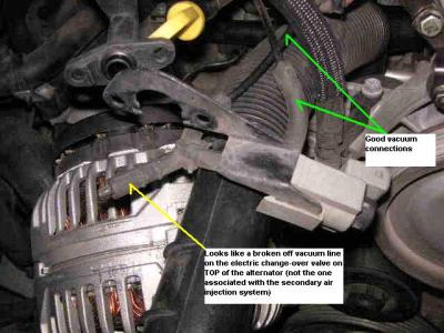

Does this look like a broken off vacuum hose?
If anybody with a 2000 or newer 996 would take a look at their electric changeover valve, the one that sits above alternator and is easy to access, can you tell me how many vacuum lines should be connected to it?
Here is a photo of mine. Doesnt it look like a vacuum line has broken off of it? There are 2 good vacuum line connections to it, and a 3rd which looks like it is broken off. I cant find a loose line anywhere that might have mated up with it though. Hope I dont have to pull the engine to find it!!

Jeff:
The broken one is the supply line from the intake plenum. You probably have a vacuum leak right now. To help you trace it, here are some pictures of what it looks like.
The broken line goes to that white vacuum backflow preventer on the intake. It may have one or 2 supply feeds on it depending on whether or not the car has PSE.
