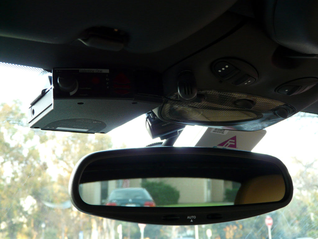

I did investigate how the housing was assembled. Two things stopped me for the moment. 1. i don't know how much room is underneath the housing; e.g, is there enough room to mount the nav-tv mic since it's about 1/2 inch high. 2. there's been some discussion on the location that gives the best audio to the person on the other end. Supposedly the overhead position is better but i don't know that for a fact.
the instructions for the navtv mic indicate that they reccommend install near the overhead console. i'd prefer the OEM location

that mic doesn't look like the one i have on my tooki. Is it a different mic ? Mine has a clip and a swivel to adjust the mic.
That looks like the microphone I got with the Tooki. Here's my install location - very similar to Bob's. Scuzy - I'd be interested in a picture of yours. Moni (CEO of NAV-TV) has confirmed that this is the part he selected - it's an Ericsson part. See http://navtv.com/forum/index.php?topic=47.0
Top up, on the freeway at highway speeds, two reports now have said that the conversation is perfectly understandable. One said it sounded like a speakerphone, the other said it sounded like a normal cellphone call. I haven't tried top down yet.

Maybe i should velcro the mic onto the top instead of cliping it into the sun visor.

I have the mic installed just left of the HomeLink overhead panel. Works great with the top up. The noise cancellation is so good, people have NO IDEA I'm driving! I contacted another Tooki user and he otiginally had the mic installed in the OEM steering wheel position, and he said it sucked and had it moved to the HomeLink position as well later and it was the best spot for him as well.
HOWEVER...with the top DOWN in my Cabriolet, unless I'm at a stop light, the other end of the call can barely make out my voice due to the severe noise (wind noise is too much for it I expect).
I can live with that though. Even my Jawbone BT headset can't kill the wind noise, and is overwhelmed, so no suprise there.
