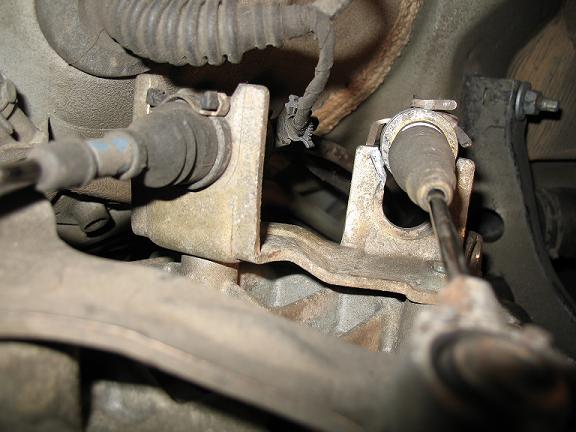

I was just driving back home on the freeway and my transmission won't engage in 5th... the rpm almost passed the reds/limter but lucky I realized it and back off on the gas pedal. I downshifted to 4th and it was ok but feel like it's barely engaging so I stop to the side of the freeway and see I can engage in the other gears and it's also feel like it's barely engaging. After that I just kind of limb home on the inner roads. Is this mean my clutch is toasted? I have 75K on the C4 cab with some AXs. I have never had a clutch went out on me before since my previous cars were either sold before I have to replace a clutch or automatics. Does anyone have any sugguestions for on a transmission shop around Santa Clara CA area beside the dealer? What is the average cost to change the OEM clutch or maybe any upgarde clutch sugguestions if it is a clutch job...? Thanks in Advance.

Non-dealer Porsche shop quote me $1500 for clutch replacment. I will call the dealer maybe this week to see what the different is. If it's not too great than I probably go with dealer. But I will look at the linkage first myself before all that to make sure it's not a simple linkage problem.

Anyone have a pic or diagram of specifically what I need to be looking for when I check the linkage?

I probably look at it this weekend but if you look couple of topics down you will see someone got the gear stuck in third and there are some information there: http://www.renntech.org/forums/index.php?showtopic=16213

I studied the work Straspec did on replacing his cable (thanks for a very thorough DYI w/pics.), looking specifically at the linkages. I got under my car last night and had my pit crew (wife) go through the gears so I could watch everything work. Everything seemed tight and looked almost new. I didn't get inside the console.
I then did a quick clutch bleed. I saw that my fluid level was at the max mark, so I just hooked up the Motive w/o adding any fluid, pressurized the line to 15 psi, and bled about 2 oz. of fluid through the line (this took the fluid from the max. to the min. mark). I then topped of the fluid w/ATE Blue. No problems with the bleeding and I must say, the clutch seems to work noticably better. I really wasn't a believer that bleeding the clutch was much more than pm, but it seems to work OK now.

Finally got a chance to figure out what the problem is. I took the center console out to check the linkage and everything looks OK. So I jacked the car up and crawl under to check it out and found the linkage has came off the mount. I must drove over something on the freeway and knock it right off. The clip was twisted and a piece was broken off one end so I will need to order another clip to replace it. Whew, at least I don't have to change the clutch just yet. :) I did received the aluminum linkage so this is the chance to replace the plastic one. Hopefully dealer have it in stock...
