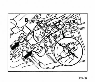

I wonder if the problem may be under the car, on the transmission driver side near the rear wheels. The cables connect to a linkage, and have two places they could come loose, first the spring clip that connects to the linkage, then the ball that connects to the linkage. Here is a diagram, you have to remove the rear cover to see them, but if they are loose or off, it will be obvious.

OK I took a look under the car nothing was loose or disconnected, but the cable "A" was severed (so thats why the shifter feels disconnected...). I don't know how this happened but the cable itself is broken. The shifter won't move side to side because its still stuck in 3rd gear. Anyone know the part number and how to install the cable "A?" by chance?

Its completely severed, I took a look at cable wire and it looks like it slowly jiggled around in the tube casing and slowly came apart, and eventually completely broke. I noticed recently that shifting was weird at some times, but then it went back to normal and now its not connected. I will try and fix it myself, it doesnt look too difficult. I just hope they have the part in stock locally...
LOL yea it was OJ... they caught him trying to steal my transmission along with the memorabilia in vegas! Thanks for the tips Izzy I did check the points in the diagram (pictures are worth a 1000 words!) and I found the issue.
