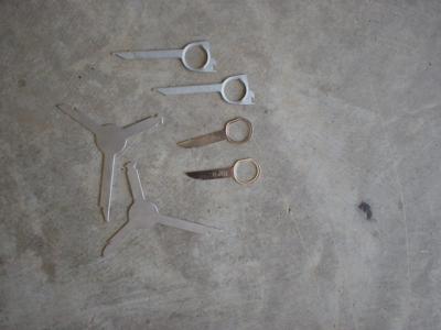

You'll need keys to do it, but they are generic VW/Audi/Porsche radio removal keys and look like this:
and go into the slots in the bottom corners of the radio. Once in, insert a screwdriver to pull with. Once out, push the blue tabs on the side to release the keys before re-insterting radio. Most installers have 'em and I'm sure for a few $ they'll let you borrow them for a minute or to just to get the h/u released.

I have heard of people shoving nail files, shirt collar stays, and other stuff into the slots. I have never tried this because I have the correct removal keys. The correct keys lock into the head so you can pull the head out.
When I bought a Becker Traffic Pro from Crutchfield there were universal keys in the box.
I know the key from the correct Audi will work. Did not know if it was also used by VW.

post-23680-1191707274_thumb.jpgHey Gustavo, I've removed many of em. I just use a long knife blade,skinny enough to fit the side slot. All you have to is trigger that blue tab on both side
