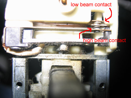

Yes, it is your high- beam stalk . Dealer will probably tell you the whole stalk switch assembly needs to be replaced and that can be steep=$$$, but if you know how to pull the air bag & steering wheel out then "you can do it". So I thought this might be able to help you.
post-23680-1192137627_thumb.jpgThis is when the stalk is pushed towards the front of the car, in proper high beam position. Note the contacts.(your situation)

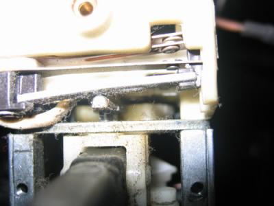

post-23680-1192137639_thumb.jpgthis is when you pull the stalk to "flash"
so, bent the high-beam actuation arm a little!
