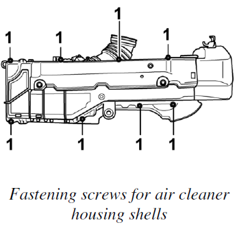

Removing and installing air cleaner element
1. Unscrew the eight fastening screws on the air cleaner housing 1.
2. Remove the air cleaner element from the housing shell.
3.Clean the inside of the air cleaner housing shells with a clean lint−free cloth, which has been soaked in solvent naphtha, and then dry it off.
Note: The air cleaner housing should not be cleaned on the outside with strong cleaning agents.
This does not loo at all like the air cleaner housing on my 2007 997. There are no visible screws. Could they be on the underside of the housing?

You need to take the whole air cleaner out of the car first. Then disassemble it.
Take the large hose clamp off and disconnect the MAF sensor cable. Remove the single bolt/mount (at the rear of the car) and lift the air cleaner out.
Be careful to not lose the the rubber aligning/positioning bushes from the bottom of the air cleaner.

Unlike the 996 there is no bolt holding down the airbox on the 997. it just rests on that post that Loren showed aided by two posts that sit on rubber grommets on the bottom of the box. Be sure that you don't lose the rubber grommets on the feet of the box (there are two) They tend to fly off when you pull the box out.

The MAF sensor does not pull off. Does one have to pinch in the little winglets on its sides or push outwards on them to get it to release? Thanks for your help.

Yes, if your connector has the tabs on the side squeeze them to remove the connector. There was more than one type of connector used for the MAF sensor.

Should be 8 screws around the outer cover (item 3) and the two grommets to hold things in place.
