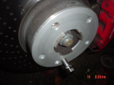

Sure! to start with for the front wheels to fit my "S" I needed a pair of 6.5mm spacers! I looked every where for em. But I didn't want the universal fit kind. Wanting either hub centric fit or 5-130 bolt pattern factory drilled, I found a pair on automotion.com for $32.00 (set). Since I was just extending 1/4 inch out , I didn't need to replace my bolts. I've had Kumhos on my car previously ECSTA ATX? but this time I'm switching to Nexen N3000. I'll let u guys know how they turn out.

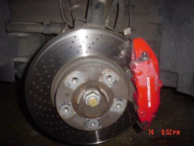

So why did you need 6.5mm spacers in the front? Was the wheel hitting the caliper?

Yes they were hitting the caliper.
7mm H&R spacers were thrown!

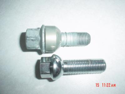

and I couldn't possibly use my old lug bolts. I noticed Porsche factory ball seat was slightly diff than a most after market ball seat. factory lug bolt's groove was just too wide , they just won't sit properly. So I ended up getting some longer bolts.
So where'd you get those bolts from??? I just installed some similar BSA wheels (but the machined/polished version) and I need some chrome bolts now. :P

No matter where u get em from , make sure they r at least GRADE 8 and above. Yes I'm familiar with those BSA wheels. Manufactured in Malaisya? They do come with diff offset options but not these wheels. I got about 80 more those chrome lug bolts sitting around in my shop, let me know if u need any.
And I wouldn't use those old factory lugs, they shouldn't fit properly.

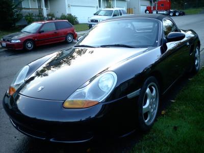

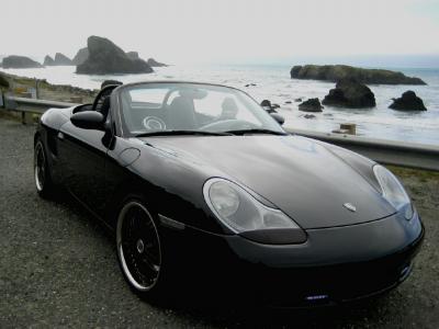

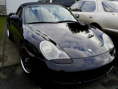

For those who requested before & after pix + possibly thinking about upgrading their wheels.
Here is a good pic of my front view to compare, I think - 17"CUP'S to staggered 18"S,smoked amber,smoked marker,silver crest,LED day running light + Zymol black wax,,, think a few modifications changed the look of my car, a lot more aggressive
Now SHE can be eaily seperated from the other 986s B)
