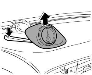

1. Insert a plastic spatula between the dashboard and the stopwatch. Lift up the stopwatch until its four clips unclip from the dashboard.

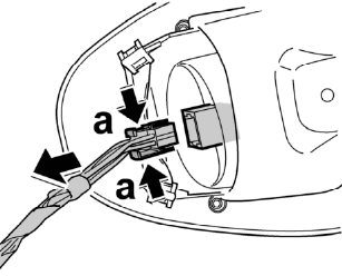

2. Release electrical connector a and pull away from the stopwatch.

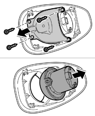

3. Turn the stopwatch around, unscrew the four fastening screws, remove the cover and take the stopwatch out of its holder.
