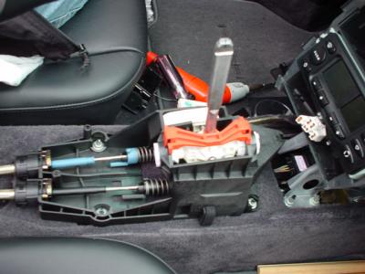

First off thanks for the reply. I don't have the tool so that won't be an option. Looking at the picture I see two linkages...1 in black plastic and the other in light blue plastic. Was I suppose to by two of the billet linkages and replace both plastic ones??? Or is the Blue one for reverse gear???
How do I remove the stock plastic piece??? Are there lock rings or something that need to be removed and the cable pulls out???

Blue is for reverse. You will not be touching that one. The EVO product will not work with the blue cable connector in any event. The black connector is the one you replace with the metal one.
I took pictures of an oem shift lever that was removed for a B&M install so you can see how the black cable connector is connected to the end of the shift lever. It is just a ball joint and comes apart with enough pressure. You can pop it apart with your fingers or lever it off with a large screw driver. If you have problems popping the EVO unit onto the ball joint at the end of the shift lever then you remove the 4 nuts for the shift tower and flip the unit on the side and give the EVO unit a wack with a soft hammer.
You first will need to remove the end of the shift cable from the end of the plastic cable connector. Count how many notches are empty first so if you give up you can everything back exactly where it was. There is a spring loaded thing you push to the front - then lift up on the cable to remove it from the connector. None of this will make sense until you remove the console and you can see the parts.
