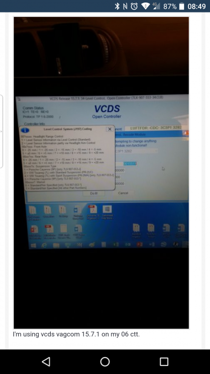

With vagcom you can set the "offset" height to increase and decrease the actual ride height of the normal position.
The level Control module coding is required to be changed. Vagcom gives you instructions as per the screen shot, sorry for bad image. There are increments from -25mm up to +20mm on front and rear axle.
This is your cheapest way to increase normal ride height I reckon.
Edited by lewisweller
