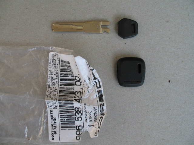

For the metal part of the key I gave the local parts guy my VIN and the key was cut at the Porsche parts warehouse, which back then was in Reno. Turned out the local dealership had the key cutting machine but they did not like to use it. When you order a key that is cut based on your VIN it is called a "stipulated" key. It comes with a black plastic plug on the top that you throw away. So if you deal with Sunset they can get you a stipulated key. You may have to fax your registration as proof of ownership.
Then I bought the valet key head. Then I needed to have the key programmed. Back then in the old days the dealer faxed a request to Porsche for the key learning code. Then I brought the car in and the valet key was programmed with the PST2. Porsche will only give this code out to a dealer. If you go to an independent then the independent has to go through a dealer. Back then it was a flat $50 to code a key.
