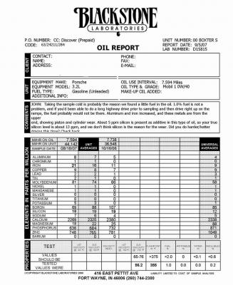

Just got my used oil analysis back so here it is FYI:
00 Boxster S used oil analysis mobile 1 0w40 8700 miles
00' boxster s with 72k miles. 8600 miles on this oil change.
Mobile 1 0W40 since new including this oil change. Normal boxster-type mixed driving, no track use. If anybody knows anything about these analyses, should I be concerned with the iron levels?

Hi,
saaber - Do not be concerned about the iron levels at all

Thanks Doug, BITOG universal average is something like 100 for iron and from what I have seen in my research so far most Porsche's with M1 0w40 have 20-30 ppm iron. The way the lab wrote it up made me a tad concerned but now that I have researched it I see it is normal. Also the lab's average is based on 4k mile OCI when Porsche recommends 12-20k so that makes it hard to correlate on longer oil runs (i.e. is it a linear relationship where a 8k run should equal twice the 4k average?, who knows?). There was one case of a Porsche owner with 11ppm but then the next sample with harder driving showed higher levels for that car.

Hi,
saaber1 - Correctly interpreting UOAs is a complex issue. Universal averages are at best a guide. Trending one engine or a group of engines of the same specification is the most accurate way to monitor oil condition and wear metal uptake rates. Wear metal uptake can then be reasonably assessed for "spikes" that may indicate some engine abnormality
Wear metal uptake rates are not linear and it is wise to remember that they are accumulative in real terms. So it is only wise to judge the rate at the OC point - interim tracking invites many wrong assumptions. Certail lubricants have a tendency to show higher levels of some metals than others but there are sound chemical reasons for this. They DO NOT indicate abnormal engine wear!!

Hi,
saaber - When an oil change is done the new lubricant will go through a cleaning and replating phase. This is longer if the new lubricant is a different formulation (Brand/Type) to the replaced lubricant. This affect can last for a very long time indeed in certain circumstances. It will provide anomalies in UOA results in the process - especially in regards the various additives used
As well the new virgin lubricant will have a metal content of its own - more or less
So the wear metal uptake is not linear - as well, contaminated oil tends to reduce the uptake rates in some cases. So interim UOAs are best at determining the condition of the lubricant (viscosity, water content, TBN/TAN etc) and just add to the engine's wear metal trending pattern.
Unwelcome "spikes" caused by say a fractured air intake will (usually) show a companion spike in more than one wear metal in any UOA, and this can tell a story!
So regular UOAs will form the trend, the OC UOA will be the most meaningful one in most cases as accumulation is complete

1 - Perhaps, but see above. Increased wear metals in the new oil may be a carryover from the old oil (oil coolers etc) or part of the cleaning/replating phase
2 - It is hard to say what level of "scavaging" may present. This is a factor of each lubricant's formulation and the additive package used in each
