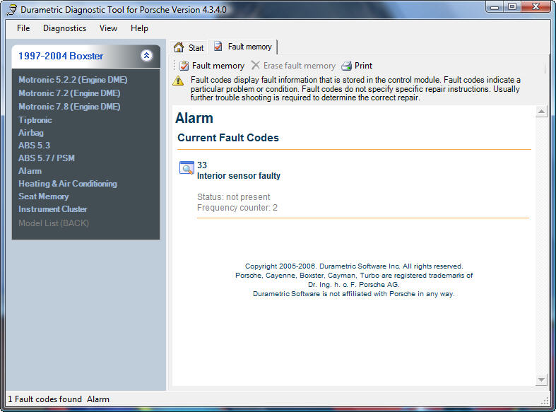

After leaving kid in the car with the key lock pressed just once , alarm didnt horn but after checked with 2 days with Durametrics found this faul code. it is needed an action like reset the code ow or it is not a problem and wait till service to reset this code thanks

my son played with the morrir and he said he hit the sensor i think i will watch the frequency as you advised me.
is any need of reset this code now? or i can wait till service to avoid paying for the reset cause durametric can not reset alarm faults

Fault code 33 Passenger compartment: monitoring sensor faulty
I would just watch the frequency counter - right now it has only happened twice. If it continues to happen then you need to replace the passenger compartment monitoring sensor.
