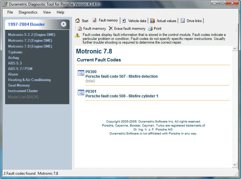

So my brothers 2.7 2003 boxster has this problem he saw the engine light lit for a FEW SECONDS after accelerating on 3rd gear
the other day i check it with durametrics and found this 2 fault codes i reset and that happened again
i reset aigai and happened for 3rd time.

uhm miss fire in cylinder 1.

just this stupid engine check after 6000rpm in any gear and the faul codes p0300 p0301 misfire total and misfire cylinder 1
