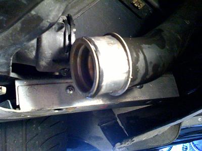

can I get a clarification as to the part number for the lower passenger side radiator hose for my '03 4S w/manual. I'm confused as to if it's the regular 996 part or the turbo. The hose has a metal collar on one end. I've got a slight leak at that side of the connection and figured I'd replace the hose as I can't tell if it's leaking from the O ring or from where the metal collar is sqedged onto the hose.
