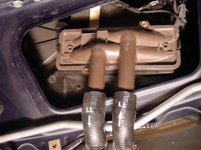

In case you are having trouble locating the heater core from the outside of the car (forward of the base of the windshield, just behind the battery) it's because it's hidden under a foam liner cover, behind the firewall with just the inlet and outlet tubes (and their corresponding hoses) sticking out.
Here is a photo, showing the foam liner cover removed and the two hoses temporarily connected :
The coils are beneath the brown plastic top cap of the core.
With the car properly warmed up, and the heat settings on high, you should be able to feel that both hoses are hot, as coolant should be flowing through both of them. The inlet (see the arrows on the hoses) should be slightly warmer than the outlet, but I don't know if it's enough to feel a difference.
