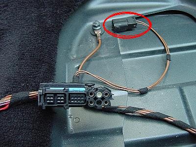

If this two wire connector is only on the passenger's (right) side, is it possible you are referring to the connector for enabling/disabling the airbag for carrying a child seat in the passenger seat?
Do the wires and the plug look like those circled in red in this photo?:
Regards, Maurice.
Regards, Maurice.
bingo.
thanks man.
ok so it does nothing at all in my case
woo hoo
