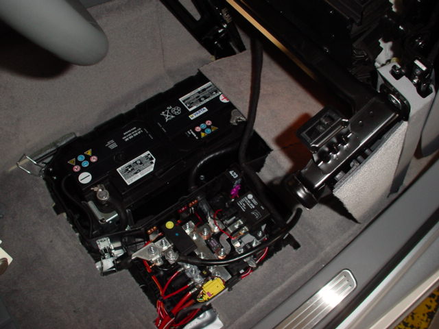

Why not just buy a high quality replacement battery for the OEM. Putting one under the driver's seat does not sould very safe in the unlikely event of an accident.
:jump: uuummm you do realize the battery is under the drivers seat from the factory right?
Edited by gixxer1127
You have to rise the seat, remove the 2 bolts on the front of the seat base, remove the left and right trim on the back of the seat base, remove the screw which hold the heater/airco vent under the seat and remove the vent, open the battery cover on the front and the rear, tilt the complete seat to the back and remove the cover, remove the battery.
The seat can be just unbolted and pushed onto the rear seat. I leave the electrics hooked to the seat then I never worry about loosing any settings. After the seat is out of the way you must remove the lower seat mount and then the battery is under a plastic cover containing a integral vent. It's very straight forward to replace just a little more work then normal. I also use a memory saver hooked to the battery jumping points under the drivers trim panel located under the front hood.
Make sure to remove the ignition key... don't leave it in as it can power up accessories.
I believe there is also a TSB on the alternator wiring harness for the V8's that cause intermittent charging problems.
There is no room under the hood and under the back seat neither, the gas tank forms a copy of the rear bottom of the car. The firs year after the introduction you could have a second battery in option which was located in the spare wheel housing, on Cayenne's without BOSE.
When the Cayenne first came out 5 years ago the local dealership had a tech session. As a Boxster owner I did not pay much attention. Don't remember which version it was.
But I remember it had 2 batteries, and 1 was under the seat. The second picture I think is the battery where the spare would go.
