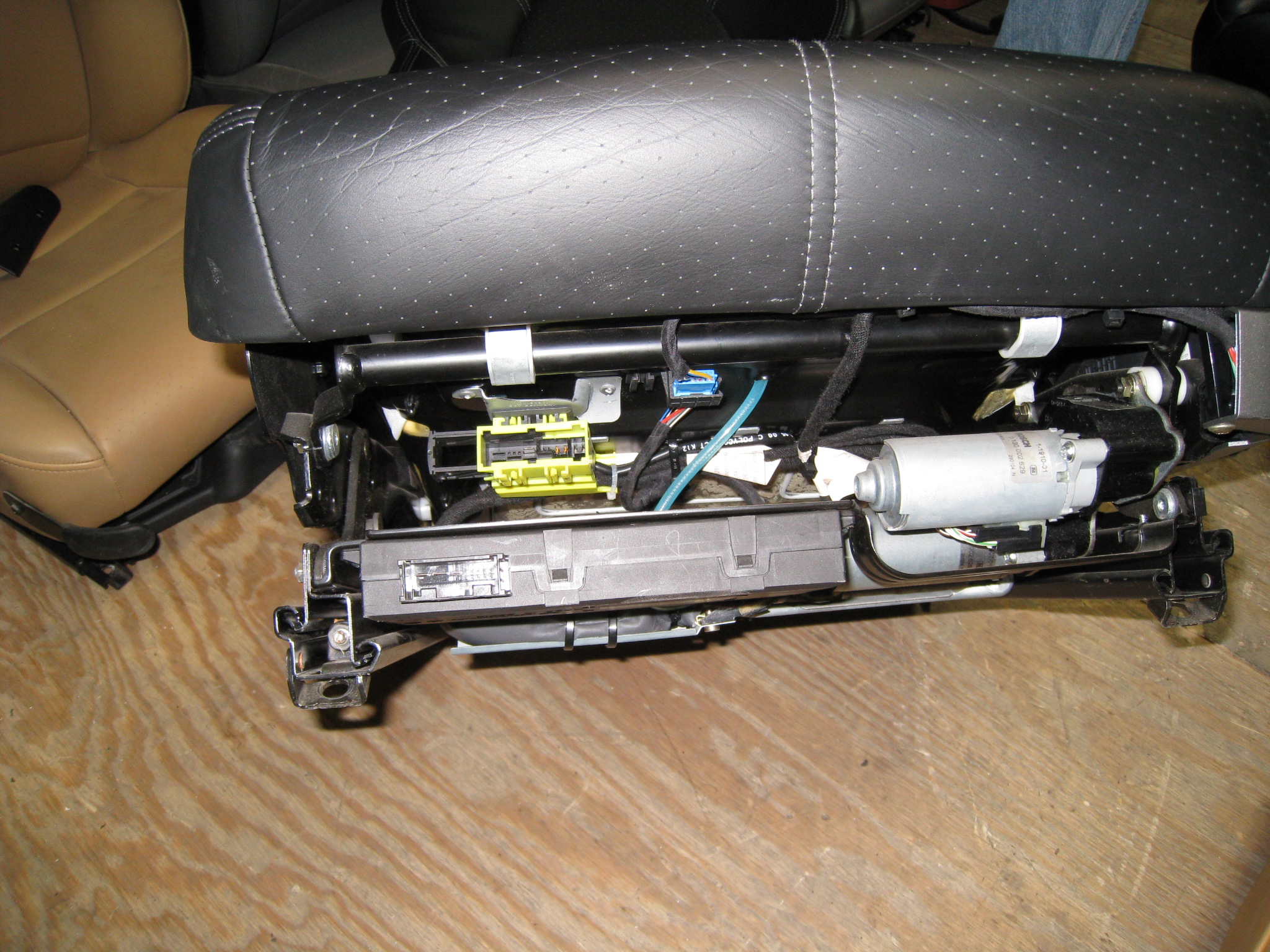

Thanks Maurice. It is hard to see if they are there in the photos I took of the underside of the driver's seat. I looked under my current seats in my car (which are heated), and I couldn't see the relays there either! Perhaps I'm not looking in the right place. Actually, I seldom use heated seats, so it isn't a big deal. But if I could establish that they are not heated, I might be in a better position to get them at a discount. I appreciate you taking the time to provide this information. I have attached one of the photos I took of the seats I'm considering, in case you can see any tell-tale signs of heated seats.

Ken:
I could not tell from that photo, although it is well focused and has good resolution. The main connector (yellow in the photo of your seat) is obvious from this angle. It might help if you have any photos taken of the actual underside of the seat bottom and identify which seat it is (driver's or passenger's) each time.

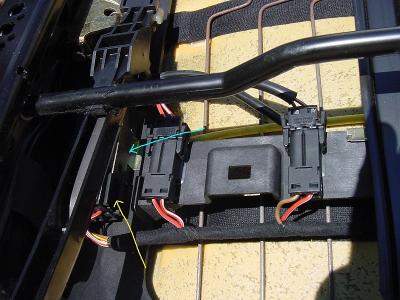

Here is a photo of the seat heater relay under my driver's seat where the relay is framed with a blue rectangle:
Here is a photo of another view of the seat heater relay, this time under my passenger's seat. The blue arrow points to the bracket. The yellow arrow points to the connector:
The photos might help you compare and locate yours.

Hi, I am new here - looking for the wiring connection to the memory CPU of a 997 seat. The picture Ken has posted shows this memory CPU (black box) right in the center. Does anyone have information about the electrical connections going into this box? I need to power the main plug on the front left side. 3 large pins, and a few small pins. Which is getting what signal ...?
