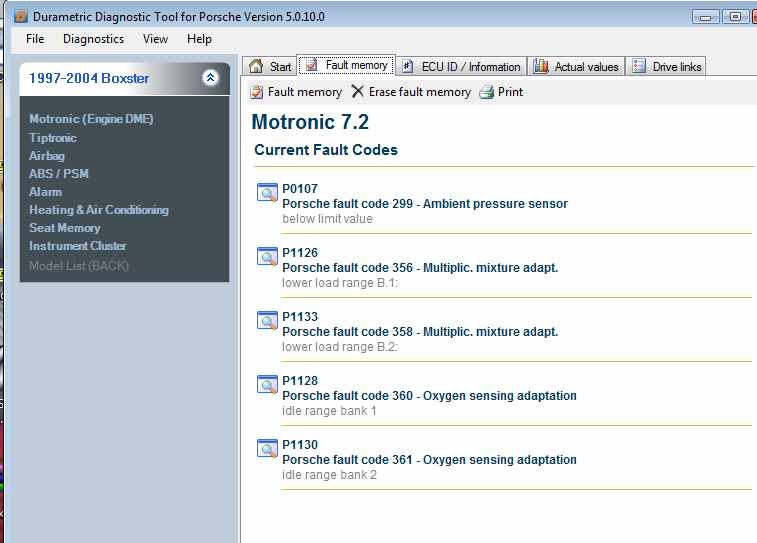

Does anyone have a pic or step by step directions to get to the MAF. Do you access it from the top where the roof folds into? Hoping to clear the Dura Faults attatched by first cleaning the MAF then later replacing.
