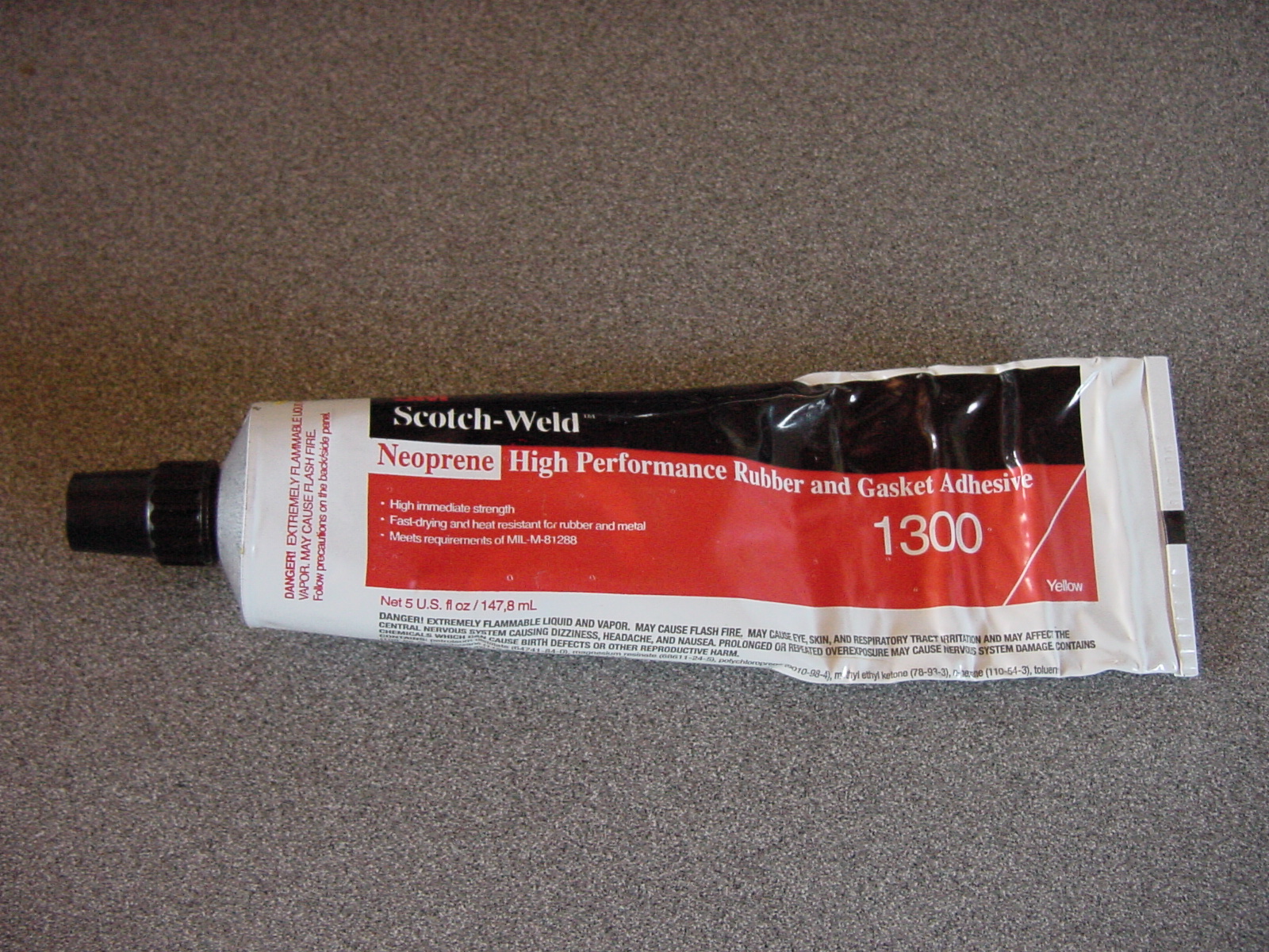

When I had to re-glue the rear of the canvas onto the rear main bow of the OEM '04 glass-windowed top that I recently put on my Boxster, I had a conversation with one of the experts at 3M.
For gluing canvas onto metal (steel, aluminum, magnesium, etc.) he recommended 3M Scoth-Weld Neoprene High Performance Rubber and Gasket adhesive 1300 (3M part number 62-1300-2631-3). It has made a bond stronger than what the factory had on there and will not come apart.
Here is a photo of the glue:
You may be able to find it at an auto paint store. Otherwise, you can order it direct from 3M online or by phone.
One word of caution. I used it in a part that is hidden when the installation is complete. I am not sure what effect it would have just under an exposed part of the canvas, so make sure you only glue the flap with the holes in it, and not the face of the shoulder plate itself.

I got a tube of the 3M 1300 adhesive and it worked wonders. With the rated 150lbs per square inch of shear strength coming from the adhesive, getting the plates and cloth to align to the holes in the frame was a breeze. And I'm happy to report that it can safely be used on the opposite sides of the visible areas of the canvas with no fear of leakage to the other side. This was handy for neatly creasing the canvas around the bend of the aluminum plates.
