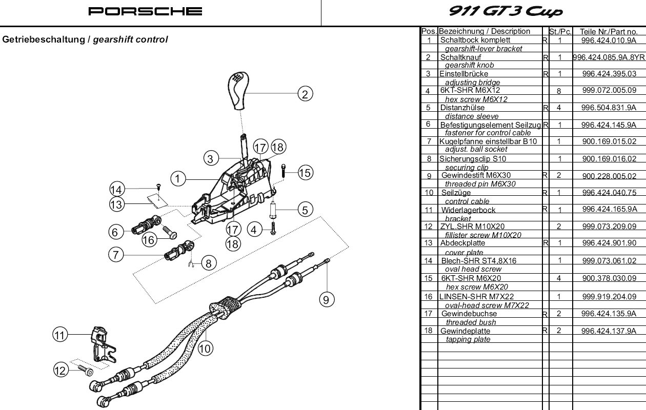

Would like to change the OE '04 GT3 shift cable to the one used in the Cup car. Need P/N's and input as to what a "kit", which would include all items needed to do this, might be. This has been done by others but the parts list and numbers are apparently restricted from the public in general. :rolleyes: TIA
