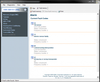

So my alarm has been randomly going off when locked and sitting idle. Happens mostly when the tempurature changes throughout the day.
I bought a Durametric scanner to try and track down the offending sensor, and initally thought it was the interior sensor. I replaced it, and it is still falsing.
Now when I look at the durametric I saw that error code 54 for the tilt sensor had incremented by one count, and noted with "not in idle position"
Does my '02 US car have a tilt sensor and where is it located?

hmm- I wonder why I would be logging a tilt sensor error if I don't have one?
Fault code 54 Radio receiver defective
Do you have an after market radio?
Fault code 33 Passenger compartment: monitoring sensor faulty
Bad passenger compartment sensor?
Fault code 42 Wrong key or wrong transponder pill
Sometime a bad transmitter battery will give this code - especially if you reset it by reversing the battery.
Fault code 60 Central locking limit position 'Locked' not reached
Most often caused by not having the door shut all the way and hitting the lock button.
Personally I would erase these codes and see if they come back.

Thanks Loren-
I cannot erase alarm faults with duramteric, but they do show count increments.
I replaced the compartment sensor
42 and 60 have been there for a long time so i'm confident that is not it.
so 54 is the radio and not tilt sensor eh? so much for Durametric accuracy.
I do have an aftermarket NAV / DVD unit (Kenwood) - Odd that I have had it installed for some time before the false alarms started.
Should the wire for the radio alarm be grounded to body, attached to the kenwood chassis or simply taped up and tucked away? I will pull out the radio and have a look.
Durametric usually fixes errors pretty quick when folks tell them about the error.
NAV/Radio wire (when using after market) -- Taped up and tucked away.
Thanks again Loren. It could be the wire is somehow touching something and setting off the alarm, will have a look at it and post my findings.
The engineer at Durametric (his name is "Duram" if you can believe it.. heh) is a really nice guy, i'm going to let him know about the incorrect code.
Edited by p0rsch3
The radio/nav wire is in the connector plug (unless you cut it off).
do you happen to know the wire color? I did not cut off my plugs, I simply tapped into the wires with scotch-locks. Seemed more sane to do it that way. :)
Look for a Brown/Blue wire from the original radio connector and remove the pin and tape it (or cut and tape the wire).
Loren- I think that was it. Pulled the radio and I had left the blue/brown wire attached to the radio chassis bracket connector. There is a factory spade connector on the radio mount bracket that the wire plugs in to, and a piece of metal makes conact with the body of the aftermarket radio. The wire comes out of the bundle of wires for the intermittent wipers.
I unplugged the wire and taped it up, I will know in a couple of days if this resolved the issue.
