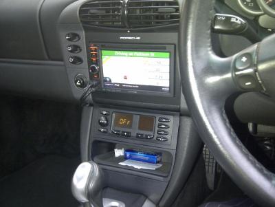

Hi all,
I refinished my trim plate to match the textured plastic on the dash in my 02 996, It came out great!
Looks as close to factory as I think we can get, Now I wish I could get rid of the "Pioneer" wording on the radio.

Hi all,
