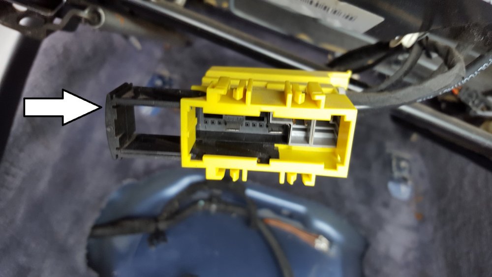

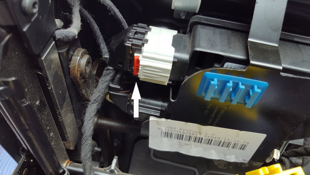

I decided it was time to change the serpentine on my 987.1 this morning and so had to remove the seats (well not a necessity but doing a bit of cleaning as well was in the plan). This thread gave the little oommphh required to do it as removing seats on the 987 seemed to be still a vague thing. So removing the four Torx wasn't a big deal but the wiring was more subtle as the connectors are bigger than on my Echo (no seat air bags to start). took a bit of studying the big yellow connector to realise there is a black slider on its side, pull it all the way out (1-2cm) and the connector splits, bingo on the driver side. On the pax side there is an extra gray connector that has a red slider, same method applies and you're done.
Hopefully you have disconnected the battery, fumble on yellow connectors can end badly with power on. This is just a warning to prevent your health.
