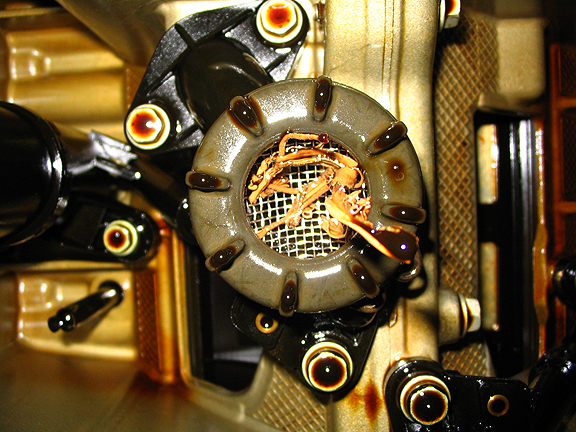

On Tuesday evening March 11, 2008, the engine of my 2000 Porsche Boxster (5 speed manual) suddenly began blowing large amounts of smoke and shut off abruptly. I had the car promptly towed to a trusted and experienced Porsche mechanic. He removed the lower oil pan and diagnosed that the oil strainer became clogged with silicone sealant, which had broken off from inside the pan. This constricted the oil flow and caused the engine to seize. I'm adding some pictures to show how this looked.
The mechanic confirmed that this problem should be considered a manufacturing or repair issue that could not be prevented with regular maintenance. Nothing abnormal such as warning lights or increase in temperature indicated an impending problem. I purchased the car with only 22,000 miles on it and it still has less than 100,000 miles. The car was serviced just 7,000 miles ago and I noted the oil level was full that evening, having filled the gas tank just 2 miles prior to engine failure. I have maintained the car to the letter of the service manual, and the mechanic stated that the engine was otherwise in excellent shape, noting how the engine's oil and other components showed no indication of other issues.

I also feel it was a mech failure and not Porsche's fault. A mechanic could of easily put too much silicone or sealant and when he tighten the bolts/nut the silicone was squeezed out and the remainder was pushed in into the engine casing and out of the engine casing. This is clearly a mechanic error. What kind of repairs do you have to get done to the car so it can be back in running condition? Good luck
