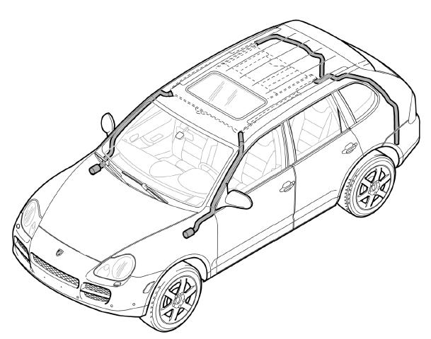

Thanks Loren....I figured those drains to be where your pics indicate....question is how do I get at them to either check for poor fitting connections or simply to blow them out....Cant see where the tube exits the car. Shouldnt it be in the rear wheel well? Even if its clogged wouldnt the water just remain in the roof rail slots and simply not flow down the tube? I have a feeling its just a matter of poor connections and they are leaking. How do I get at them?

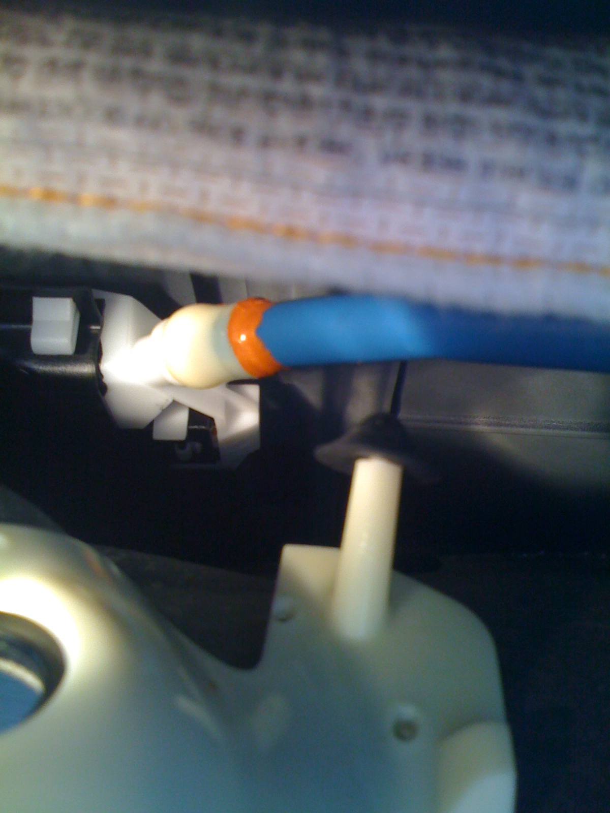

I just had a similar experience on both rear drains on mine. The dealer claimed the same "clogging" but mine were where the connectors attached to the hoses themselves and not the ball part coming off of the rail assembly. Here's a pic of where I had to apply silicone.
