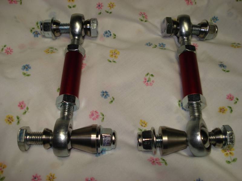

Hi,
Last two pictures.
Paul

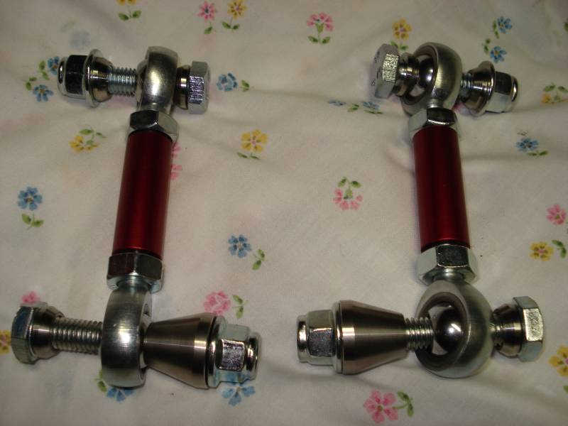

Hi,
Last two pictures.
Paul

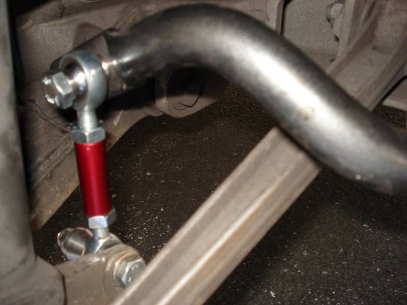

Hi,
Yes you need drop links. The link below shows pictures of my install.
https://www.millaracing.com/products.php?ma...cts_id=631&
If you use the stock drop links, There will be alot of noise when you go over bumps. The adjustables make
some noise when in a netreul setting. adding a little height to the right or left will
reduce the noise completly. The car will have a very little tendency to turn in a direction.
Good luck with the front sway bar. Expect to pay alot of money to install the front.
Paul
