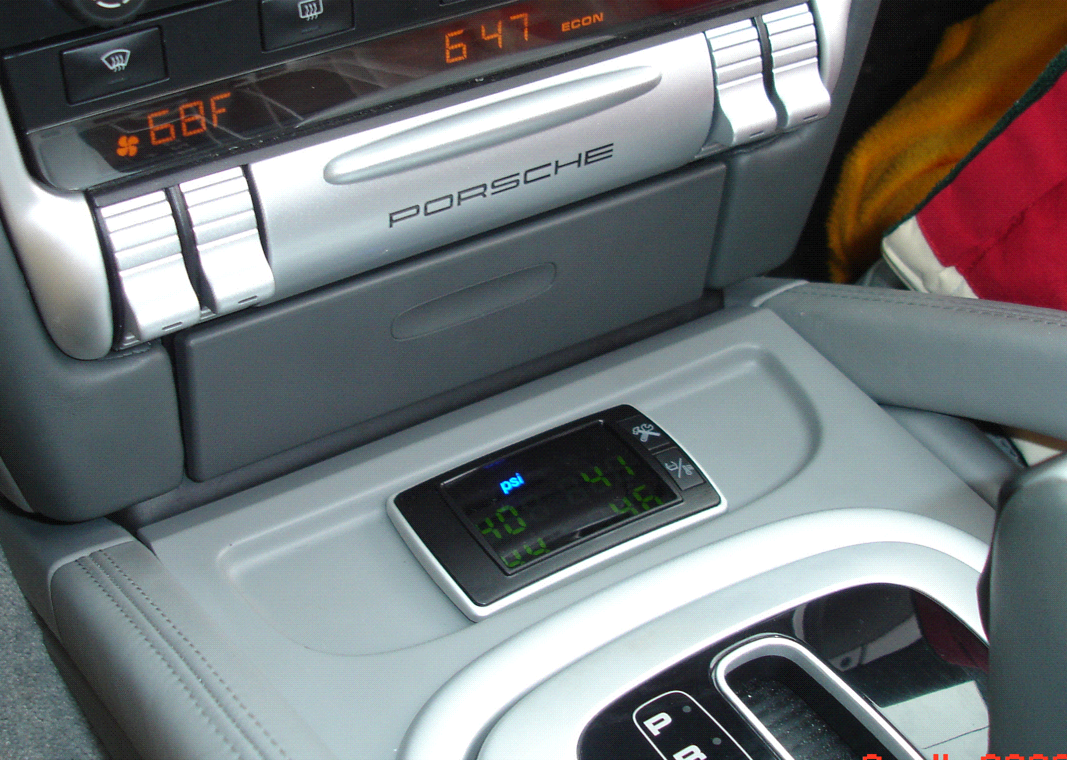

I installed an aftermarket TPMS from Orange Electronics. I love it. The display actually matches the factory dash...silver boarder with a black inner area. Check out the pics. I like the unit because it constantly shows the pressure, or temperature or both (cycle), of all tires all the time. The digits actually turn red when the preset low or high pressure is hit (or high temp).
I had to disassemble the unit and modify the casing to flush mounth the unit. But, it was well worth the effort. It look factory. :D
I used a bolt under the center area for ground and the far left wire in a 5 wire-wire harness that's located directly beneath the TPMS. Be sure to use the far left, not the right. The right one will be on when ACC is on, but will go off when the brake is depressed. It's the signal that tells the shifter that the brake is depressed.
