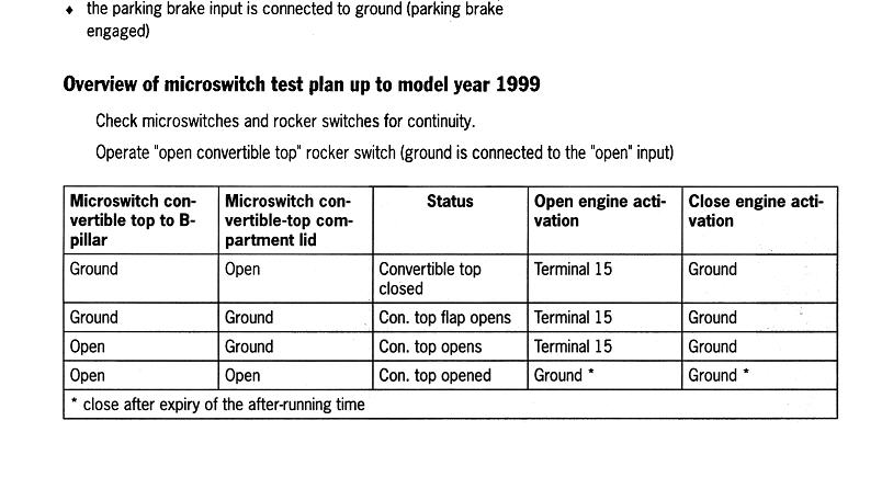

Of course the switch may be to blame but there are other sensors that must read proper values before an UP or DOWN process can occur. This includes switches on the door piller next to the drivers shoulder as well as the switches at the top of the windshield. I"m a bit rusty at the moment telling you the logic and location of each switch but they all can be to blame.
If the problem is rears it's symptoms in both up and down positions I would start with the main switch and then check 12+ to the top transmission motor. There is good information in the Bentley on this stuff.
One of the Porsche tech manuals have a list of the microswitch logic. Since I'm so rusty I'll reference here in this screenshot.
If you want to see the entire section on convertible tops send me a private message.
