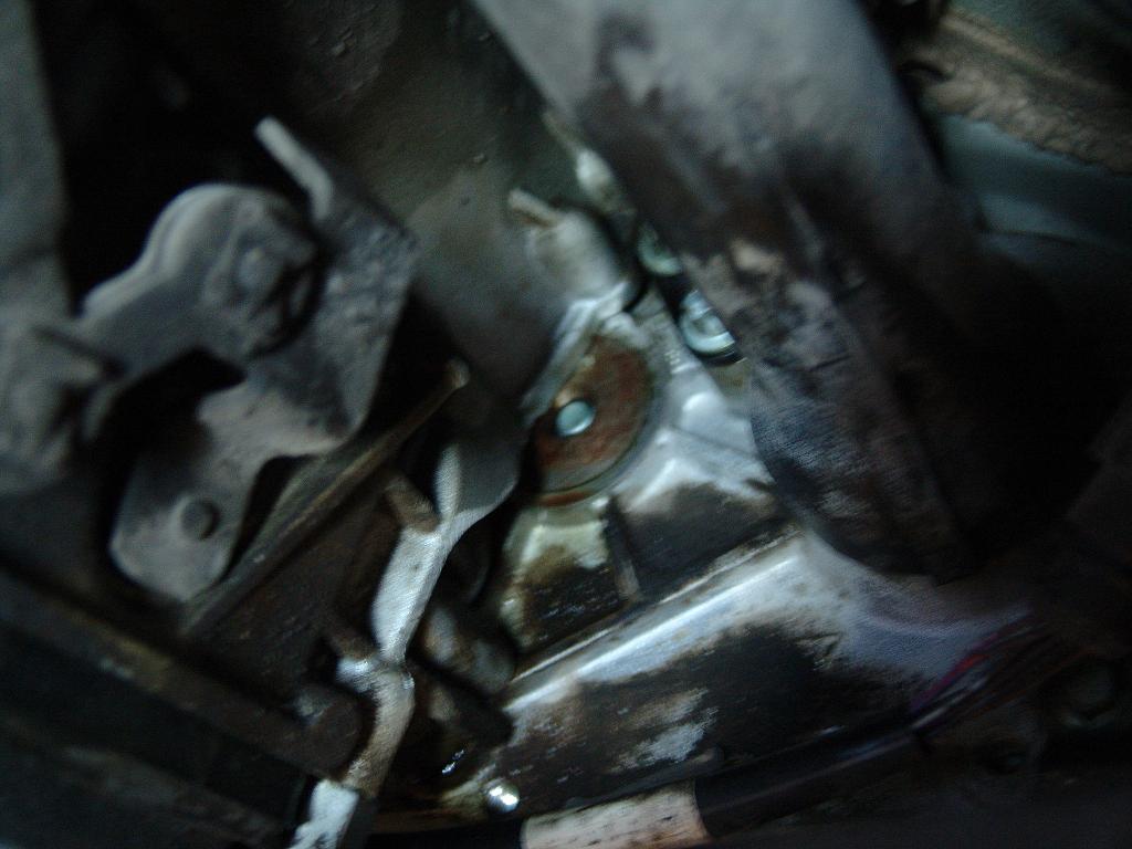

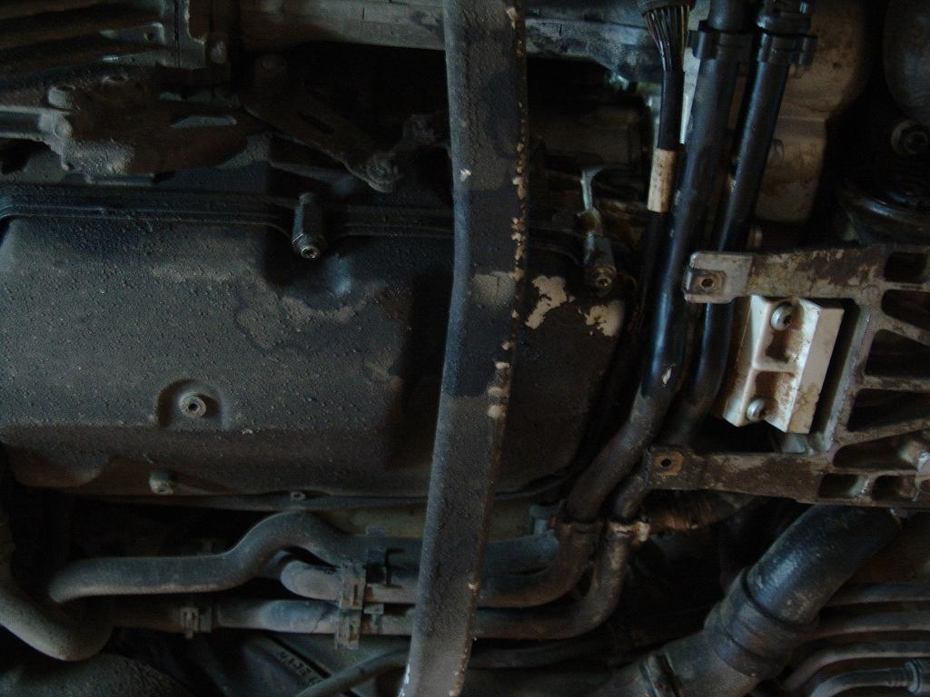

i find some oil spots under the car between de gearbox and the engine ( i think )!!! what can it be ? please guy help me with some answers !!!
i hope that is not the gearbox or something serious, the car is a tiptronic and 41.321Km
Leaking seal behind the torque converter of the Mercedes-Benz tiptronic is most common. The turbo engine gives no RMS problem. Remove both rubber plugs between the tip. and the engine ( bottom side ) and go with your finger in the hole, in the direction of the tip. and you can feel the oil in the converter case.

The seal is not showed ( behind the torque converter ) If it is the seal, remove the engine and the transmission as a unit out of the car and separate, remove the torque converter and change the seal. The seal cost is just a couple of €, the oil a little bit more and the labor a lot more.

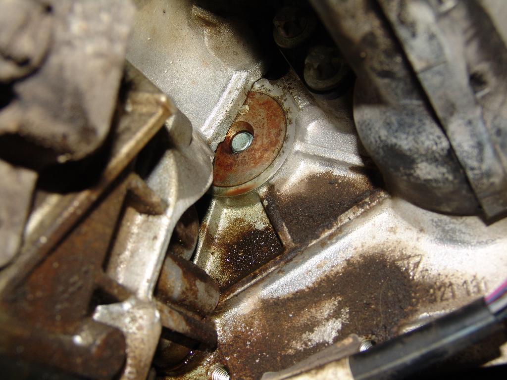

Are you sure that the gearbox is leaking at the rear side? This is uncommon. Arrow 2 is a paper seal ( special paper ) that you can create by your self if not available, some older mechanics and classic car enthusiast can do that easily. Arrow 1 are snap rings not seals.

i know that i can make this seal but porsche romania will not make this and they don't what to repair it ONLY change the gearbox !!! the snap ring i know that are not seals but they don't have code number and i can not order them !
