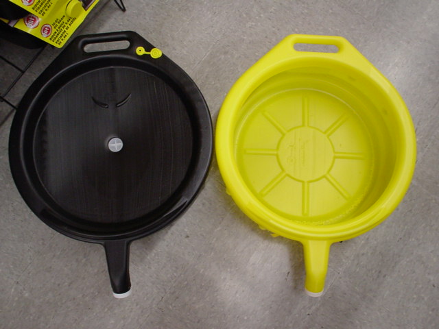

Mine is like the yellow one on the right. It is an open container.
Watch out if you have one like the black one on the left. It has a cover with a drain plug in the middle. The hole for the plug is so small that it can't always handle the large amount of oil that comes out of the engine quickly.
I always change the filter first. Replace the filter and screw the cannister on. Then I slide the pan over to the drain plug. That way when you drain the oil there is already some oil in the pan plus the filter, and I don't get oil splashing out of the pan.
I have the black one in Jeff's photo on the left; it is about 15 years old and has many, many oil changes under it's belt. The flow of oil into the container is much better if the yellow pressure relief cap is open; I've never had it back up. This type is also good for holding the removed filter, filter housing, and drain plug (the large drain hole in the center has a screen to prevent the drain plug from falling in). I just let these things drop into the catch pan upon removing them. Since it is enclosed, moving the catch pan virtually eliminates spilling. --Brian
I've used the black one - worked fine except for the time I forgot to take out the white plug.
Likewise, but I knocked the drain plug into the hole and did not notice until it overflowed.

Take the used oil to PepBoys and they will let you keep your container...but in my experience you will have to pour the used oil in their recycle container yourself!!!
