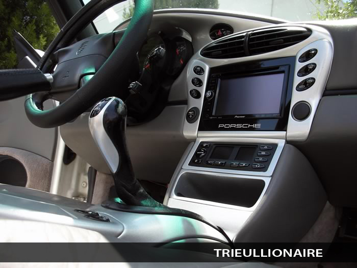

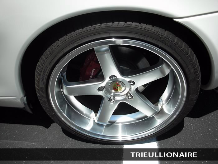

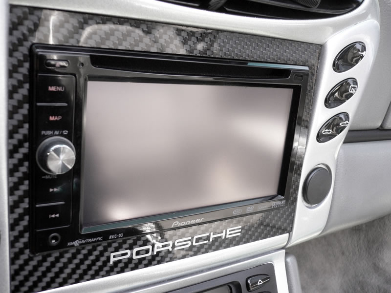

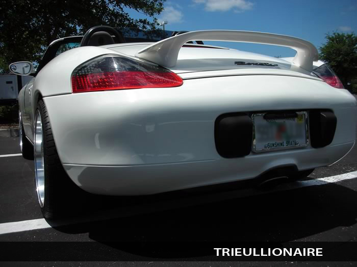

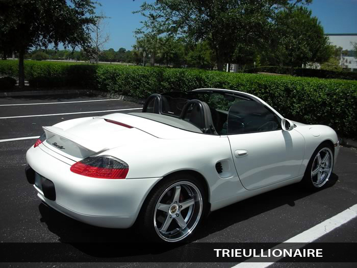

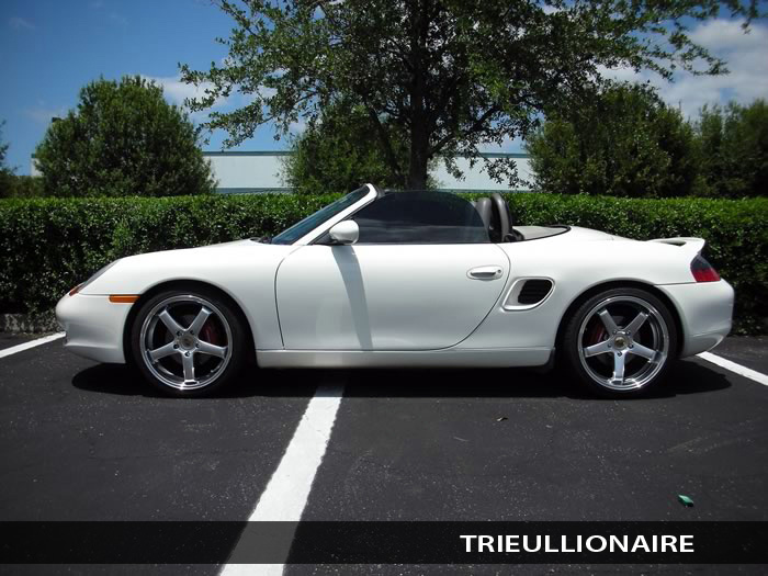

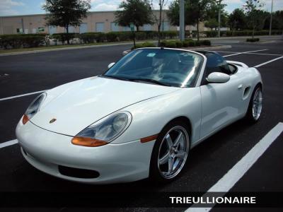

Mods to Date

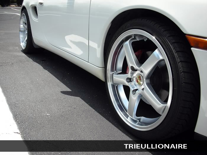

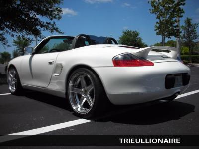

-19 inch Rims (R 275/35/19 F 235/30/19)

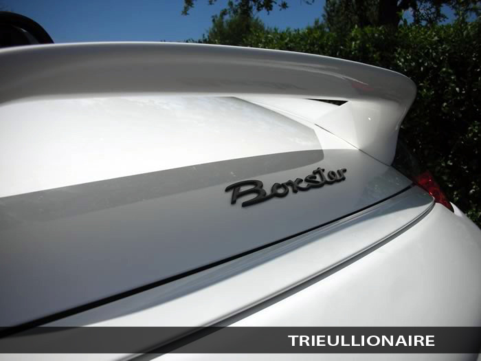

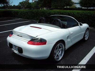

-Rear Wing Spoiler
-Silver Painted Interior Parts
>Center Console
>Arm rest
>Dash trims
-Smoked Tail Lights
-DVD Navigation w/ rearview camera
-Convertible parking bypass
-Blue L.E.D. instrument gauges
-Red brake calipers
-Tinted side windows and windscreen
-Aluminum foot pedals

trieullionaire - Where did you get the rear spoiler?
She is a beaty!!! :D
Got them from www.fiberwerks.com. It took me a while to find this spoiler when I was shopping for one. There were a couple other ones I was considering. I think it looks great because it kinda integrate with the contour of the car from the side and rear pretty well, and my OEM rear spoiler still functional when I hit 75 mph.

What are your rim widths and offsets (good clearance?) and are the silver dash parts tequipment, aftermarket, or did you have them painted?
Many will not believe me when I say this, but the wider tires enhance the overall feel of the drive. My car drives smoother & quieter with the new rims & tires as opposed to factory ones. As far as clearance, all that is needed is 1-2 mm in the wheel well. I used 6mm spacers in the rear plus added longer tire bolts to get a few more threads to bit. Had them now for 4 months now, zero issues.
I took all the parts & sanded it down with 440 grit sandpaper, then washed/ dried it & wiped with a tacky clothe to remove any dust or small debris. I then had my brother primed & painted it. There's a thin layer of primer & metallic paint and 4-5 coats of clear gloss enamel for maximum strength & durability. My brother baked all the parts for 2 sunny days straight to have everything dry to the core. Very labor intensive- for all the parts we did, you're looking at a good 4-5 days (dissemble, prep, paint, cure, reassemble). But with all hard work, you get to enjoy the fruits of your labor afterwards (can't say I speak for my brother, lol)!
440 sandpaper
tacky clothe
Primer spray can
Rustoleum Plastic spray can-Metallic
Enamel Polyurethane Clear Coat spray can- Glossy Finish
$30-$40 bucks

Hey trieullionaire
Where did you purchase the LEDs from?
I spotted these on ebay and liked the looks of them...just don't know about the quality <_< though for that price...
http://cgi.ebay.com/ebaymotors/ws/eBayISAP...898704&rd=1
Yeah I bought mine from Zomk Speed on Ebay. It's actually pretty affordable, $156.00 I think. So far no problems, I get a lot of people telling me the lights are extremely bright when I step on the brakes. I bought mine because one of my originals had a big crack in it, and so decided to look at some alternatives.
http://cgi.ebay.com/ebaymotors/97-04-PORSC...99207QQtcZphoto
Do these come with the leds or do you have to get them separately?
