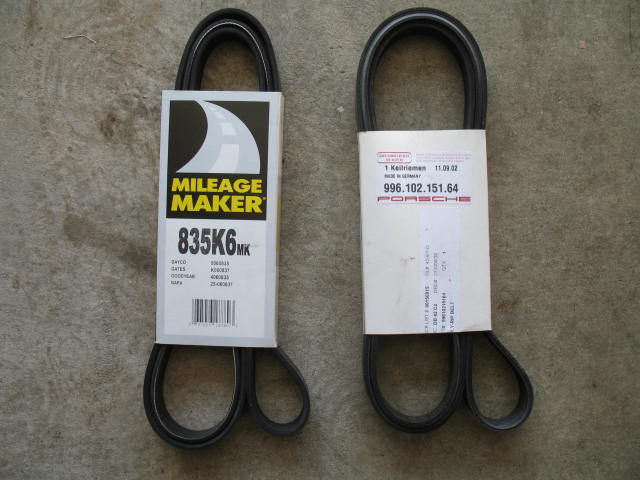

The belt I bought from Kragen for 19.99. It is made by Goodyear in Canada.
http://www.renntech.org/forums/index.php?showtopic=2325
So it is not necessary to always buy service parts from Porsche.
