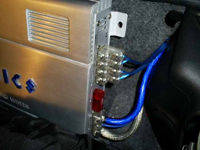

forget those hardnesses , just hard - wire them,,,
I agree! It's like buying a porsche and then running bias ply passenger tires! :o Your stereo is only as good as the weakest link. If you have replaced the head unit, amp and speakers, why skimp on the wiring?
