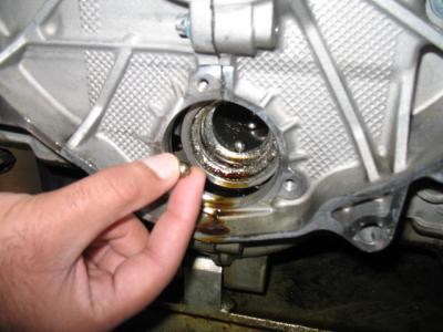

There is a bearing on the end of the shaft. I have been told Porsche went from a double to a single bearing. I was told the year but forget - I think 2001. This is why you seldom hear of intermediate shaft failures on the older cars.
Picture is a 2003 2.7.
TP, can the bearing be removed from the case and shaft from behind that cover? Thanks.
Usually there is a lot more damage than just the bearing (a whole lot more).
I was wondering if it could be replaced before failure. According to Tool Pants, guess not. Thanks.
Share this post
TP, In that photo the bearing appears to be a ball bearing. Do you have any pics of the older style bearings? I thought they were roller type.

The engines that we have torn down to study have had similar reports of failure when the IMS lets go...
But most recently we have seen a rash of failures from worn timing chains that shear bits that end up being picked up by the scavenge pumps. This ends up resulting in a jammed scavenge pump that shears the pump drive as well as breaking the drive that it engages into, on the cam sprocket.
In one instance this led to a catastrophic failure when the valve timing was advanced enough to contact every piston to the valves as the cam sprocket slipped on the cam drive when the pump seizure occured.
The bits in the oil may be from a worn timing chain that has lost pieces... Like this one.
That led to this...
Which led to this
The engine only had 32K on it.
The timing chains in these engines seem to wear quite quickly as every engine we have torn into had worn chains. There is another presumption that we believe attributes to this but if I mentioned it a battle would erupt about oils :-)
We have seen several IMS that have not totally failed yet that are filled partially with oil and were ready to let go.. We believe that the oil inside the IMS is can create out of balance issues under acceleration and cruise at some speeds and that may work hard on the IMS bearings and lead to a failure.
We are documenting every failure we see and trying to establish trends to help understand what happens, when it happens and why, so we can upgrade to avoid future occurrences.
