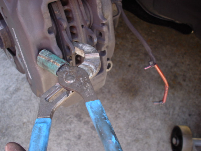

  2. This is the final result. As you can see the brake sensor wire is missing. I decided not to drill the pad for the sensor and simply shortened the cable and tie-wrapped it:
    Does it look right to you? (hi-res image)

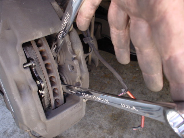

  3. The front Hawk HPS pads are missing the little notch my finger is pointing at on both sides. Is this normal? It seems like that notch is where the spring clip pushes against:

2) OK
3) Contra weight against vibrations ( = noise )
