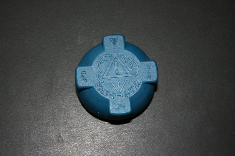

I believe there was an upgraded cap for the tank... it maybe a leaking cap.
So i cleaned the coolant and refilled the tank.
i was sure it was going to leak again, but since then (2 days ago) nothing leaked.
im a bit confused.
i thought i had a cracked tank, but its not leaking , what else could this be?
ive driven the car for about an hour to make sure i get it to running temp and pressure but still no leak.
Check the cap part number ...if it ends in ..00 change it for the later cap with PN ending in...01.
The former has been known to let off pressure and fluid although I'm surprised that it would leak a "puddle" unless it was a catastrophic failure in which case it should still be leaking ;-))
All the same I would just fitt he later cap and keep on eye on it.

If you have an -01 cap and you still suspect a leak get the cap tested or replace it.
A cap leak is usually small - and a cracked tank is usually quite large. Sometime a crack in the tank is impossible to see until it is removed.

Also, with a bad cap you'd likely see moisture around or above the cap. It's seems to me that i've seen a picture of an .02 cap though my memory isn't what it used to be :rolleyes:
Last time I ordered a -01 cap I got an -02 cap. The package still said -01.
Well...... i do have the moisture around and above the cap, but the loss of coolant was so dramatic that i couldnt believe it comes from there.
