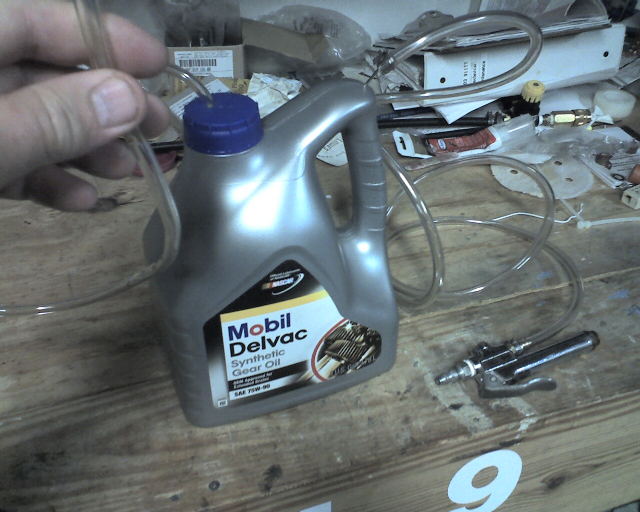

Chuck, You weren't the only one. Here's my fill method.

I just pressurized the container to about 10 psi & used a 3/8" tube though a tight fiting hole in the cap,. Used it for the tranny and diff. (picture 2 posts previous)

Dan: from your picture...are you introducing the pressure to the container thru an air needle like you'd use to fill a football? Doesn't it come out when you start pressurizing the container? I can't really see what you're using to pressurize the container....but the tube thru the lid on the top would go to the bottom of the container to pick up the oil. You simply come off the trigger to stop the air pressure when it starts to flow out the fill hole.

Exactly; the needle doesn't come out at the low pressures (small cross section 10 psi). I would puncture a small hole first as the football needle will bend before puncturing the plastic. For the cap, drill a hole slightly smaller than the tube, oil up tube and slide it in. Tube with a 1/4 - 3/8" bore works well with the high viscosity fluid.
Be careful not to over-pressurize; you know what will happen & it won't be pretty :huh:
