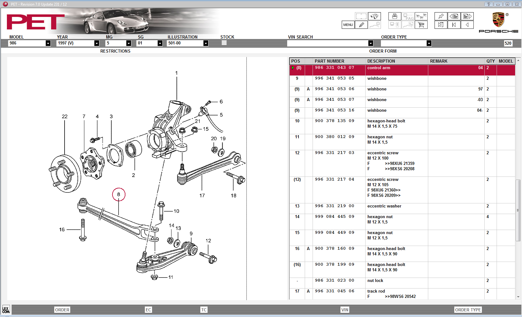

Am based in Ireland so the terminology is slightly different with part number 8 called the rear lower tie bar over here. Will go back to the dealer who fitted the rear" lower suspension arm" and find out exactly which part was fitted and compare it with the above diagram.
Hopefully it was a different part and the above suggestion will sort my problem out.

There is no need for a alignment after changing the lower control arm ( item 8 ), the replacement itself is piece of cake.

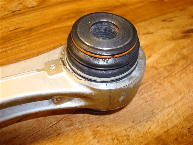

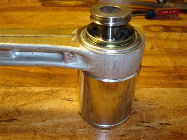

I want to say thank you to Boxsterfahrer. I also had the rattle from the left rear of my 2001 Boxster S that was ruining my Joy of ownership. I did the fix with the 1/8" punch and no more noise!!!! It all took about 1 hour.....

I just completed the repair of my left rear control arm ( item #8 on parts fich) . The right one was done about 6 month ago and now no more noice from the rear. Pictures of the repair are attached for your review
attachment=14025:Control_Arm_001.jpg]

I know of no sure way to test the control arm other than to measure the side play of the teflon or nylon insert. I tried it on my left rear control arm and found about 0.005" of side play under haevy pushing. The best way to check is to do the repair, reinstall and listen if there is an improvement. See the pictures of the repair dated 9-19-08. My two repairs have been successful and saved me about $600.00 in parts alone.

To remove the lower control arm #8 remove only bolt #10 and #15. If you remove bolt #12 you will need a realingnment.
