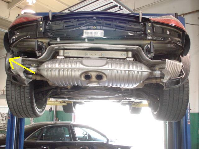

The emergency release is hidden behind the aluminum heat shield on the drivers side. You will have to pull the heat shield back and see if you can find it. It is a stranded cable with a pull loop on the end.
The only picture I could find shows it with the bumper cover off. But you can get to it with the cover on.

I found my emergency release cable behind the driver's side rear wheel plastic wheel housing, towards the rear bumper. I had to remove the rear wheel to gain access to the plastic screw and the plastic nut that holds the plastic housing to the frame of the car. I didn't have to remove the housing entirely, though. I just removed the two fasteners and pulled the housing enough so I could see into the area behind it with a flash light. Lo and behold, the emergency release cable was sitting there waiting to be fished out!
