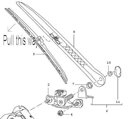

As with everything; it's quite easy once you know what you're doing. :P
Just lift up the rear wiper arm and pull the blade insert at one end until it snaps out. For a replacement I used a Duralast 15 inch one from Autozone for 7 bucks. Snap it back in and it'll work like a charm.
I hope the diagram clarifies it a little further.
