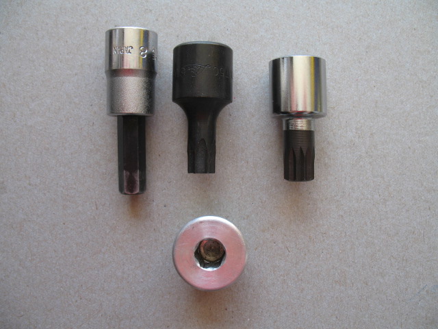

If it is really rounded past the torx bit stage, then you go to a triple square/xzn 10 mm bit and pound it in with a hammer. It is the type of bit on the right. One of the mechanics taught me this.
For others. Left is 8 mm allen. Middle is T50 torx. Right is the triple square.

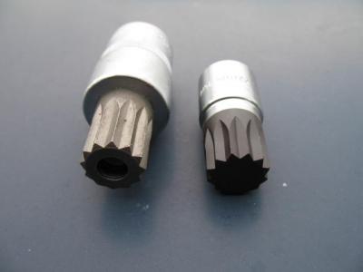

I had a similar situation when I changed my manual transmission fluid on MY 98 Boxster. They say never drain the tranny fluid until you make sure the fill plug can be removed, else you will have no way to refill the tranny or get to a shop unless you tow the car. The drain plug on the tranny was a 16 mm triple square with a hole in the middle for the drain plug. I tried removing with one without the center hole and stripped it badly.
To get the tranny drain plug out I drilled a hole in the center with a 1/4 bit and drained the tranny fluid. I then used an easy out and crescent wrench and the plug came out with no issues. If the receiving threads on the oil pan are stretched or stripped and you need to replace the lower part of the pan the cost for that will be way below dealer prices and access to the pan is very easy to get to.

Has nothing to do with the original engine oil drain plug question, but here on the left is the 16 mm triple square anti-tamper bit with the hole in the middle, and on the right is a standard 16 mm triple square. For the 5 speed gearbox drain plug.
Seems VW/Audi did not want 5 speed owners to easily to change the transmission oil. The bits are the same size. The left one looks bigger because the bit holder is larger.
