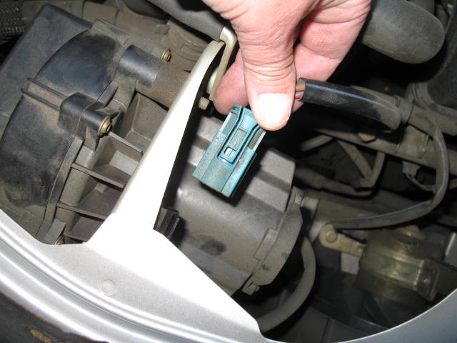

Have someone show you how to remove the engine lid. The pump will be staring you in the face. Locate the electrical connector to the pump and practice removing and putting the connector on.
Start the engine when it is stone cold. Listen to the sound the pump makes - it sounds like a vacum cleaner. Seconds later remove the electrical connector to the pump while the engine is running.
I was hearing a bearing noise and thought is was from one of the pulleys for the serpentine belt. Engine was cold. So I remove the electrical connector to rule out the pump it out as the source of the noise as the pump is noisy.
