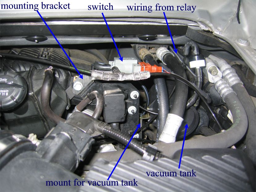

How can I check, if the vacuum system is leaking and where?
If you do a search for PSE installation help, you will find many labeled pictures of the various parts.
In the picture below, the vacuum tank is slightly to the right, and toward the front of the car from the item labeled "switch". Follow the rubber tubing from your electrically operated vacuum switch back to the tank. That is where leaks may occur, or where a check valve may be missing / malfunctioning.
The whole purpose of this tank, as far as I know, is to retain vacuum so that you may switch the PSE prior to engine start.
The additional air is the cause of the difference in sound, you can activate the air pump with the engine running without problems. The vacuum system leak test can be performed as Kim mentioned.
