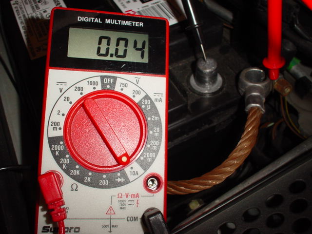

I've tried pulling out the bulbs and my battery is still getting drained when leaving it parked. I took a measure of the amperage and its way over 150 milli amps. Could you give me some suggestions on what I should try next? I think I'm going to start pulling out fuses one at a time and see when the amps drop, I think think there's a short somewhere

Peter says the draw should be no more than 40 milliamps. Not the electrical guy so I do not know how long it takes to drain a battery with a 150 milliamp load. You might check the seat back motor. http://www.pca.org/tech/tech_qa_question.a...9-284D52B42EDE}
ok after pulling out the fuses one by one, I narrowed it down to 2 items, each of these cause my amperage to go over 150 mA. The radio and the instrument cluster. i guess I can leave the radio off for the time being, but I dont know about the instrument cluster. should I just take it to the shop to have them figure out the rest? without any of these 2 fuses in, i'm getting a reading of 40 mA

yeah I understand...ok but more news...i think i really found the cause now. Its the radio. with just the dash plugged in, the amp usage just pulsates, but never above 4 milli amps. The stereo, even when off, makes the amp usage over 150 milliamps. I'll just leave that fuse unplugged for now. Since i'm going to get an aftermarket stereo, I'll just live without music while driving.
