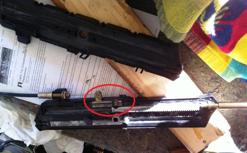

Thanks for the tip. I had originally verified the microswitch functionality with manually pressing and then moved on. Your post had me remove the carpet behind the rear seats so I could clearly see the final latch. It didn't move as expected.
Seems the metal "foot" from the final latch has broken off. This slider is inside the clamshell drive and engages with the black metal piece after the foot piece starts the sliding motion. Thus the back latch never completes.
Borrowed img from another member's rear drive dis assembly: (part circled in red)
post-75189-0-38752900-1341021104_thumb.j
My piece with the "foot" snapped off that begins the last latch travel, the black piece engages with the slide drive after foot catches.
post-75189-0-29830400-1341021129_thumb.j
Hoping I can get help from friendly fellow Cabriolet owner to get a replacement part....

Got a part from another kind member for few dollars. Popped it back in, executed calibration. SUCCESS!
Top works perfect now, awesome.

Replaced latch slider
Refilled fluid
Replaced latch protection flap
I believe the rear latch protection flap broke then the previous owner got the canvas caught and busted that foot off. From there the top stopped working. Not sure how they also busted the latch cover...

The casing wasn't damaged and just replaced the pieces inside.
Edited by 987_RDC
Share this post
Bought them from another Carrera Cab owner who had other parts of rear drive broken. Don't try to MIG weld the piece but not sure if TIG might work.
