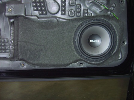

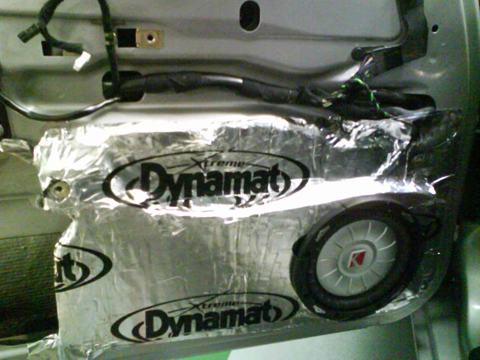

I finally replaced MB Quart 5.25" door speaker (QSD 213) with Kicker CompVT 65 (see pictures below)
They are connected in // to the MB PAB 5400 amplifier (4 Ohm/2)
BIG bass for 6.5 speakers!
I now need to fix vibration issues.
Anybody used Dynaplate to fill the gap behind the glove box?

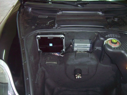

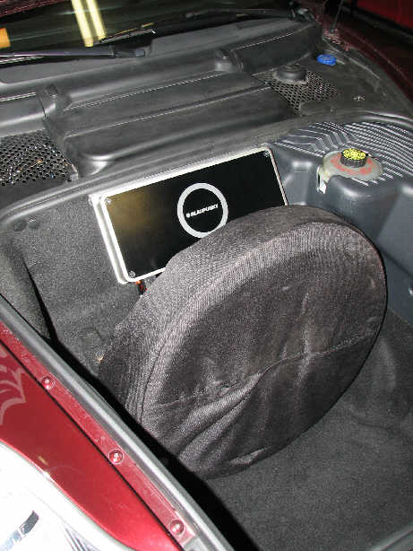

Something that I haven't really seen anyone mention on amplifiers, is physical size. When I bought my used Boxster it had a giant amplifier that took up the entire front trunk floor. I wanted something that would fit into the general area of the stock amplifier. I found 3 that looked good:
Alpine PDX-5
Infinity Kappa Five
Blaupunkt THA 555 PNP
They are all very compact 5 channel amplifiers. Alpine was a bit expensive. I would have preferred the Infinity, but nobody had it in stock. So I went with the Blau.
Blaupunkt still make great stuff though - I would have chose them over the Infinity (if choosing just by brand) - anyway how does it sound? Also a picture of how well the amp fits in the stock location would be excellent.

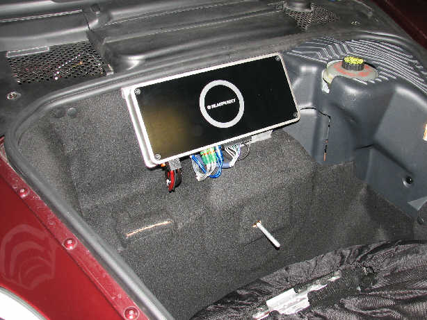

Here's the Blaupunkt 5 channel amp in the stock amp location. I made an aluminum bracket that tilts the amp back so that the lower surface is accessible (that's where the controls and connections are). It mounts using the same two bolts and lower friction clamp as the stock amplifier.
Edited by demick

Thanks for the pictures, that unit fits there quite well it looks!

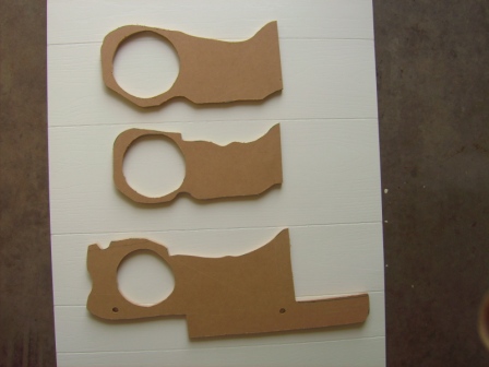

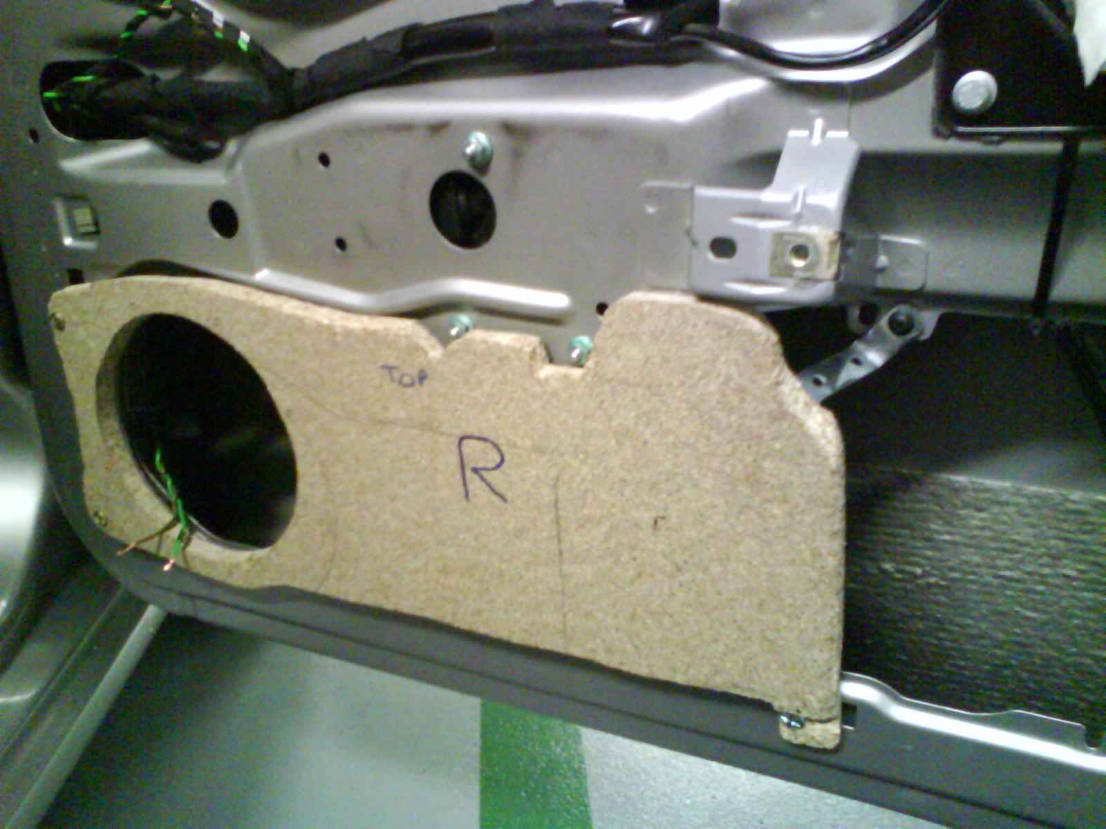

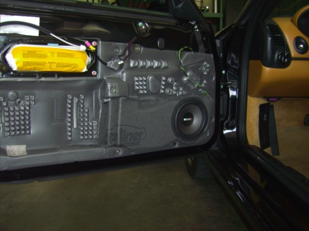

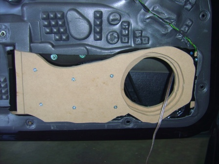

I just finished today the small sound upgrade on my '03 buddy. I finally decided for MB Quart PIV210 for the dash and PIV164 for the doors. The rear speaker kit has still the same speaker, I'll keep it as it is. The sound is powered by Alpine's PDX-5. To fit the speaker to the door I also created board's and did the whole installation based on Jinster's and Andy_M's guides (these both are perfect!!!). Except the doorplate - in Germany it's build with 3 single sheets to get more stability. I took some pictures of it.
After installing everything I spent another hour to adjusting all gain's and crossover's at my garage and was fine with the output - but let's see how it work's in the real life. I cruised with top down 50,60,70 m/h and to tell you the truth - the bass is outside the same as before, like none. However, now it's done and I take it as it is.

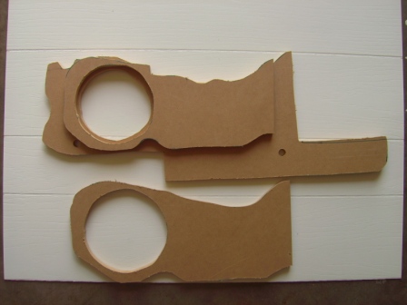

Here are now some pictures of the doorplates. The first one comes behind the doorframe, the second sheet in the middle of the frame and the last sheet sits on top. Each of them are fixed together with screws. I used Dynamat Ultimate for the finish.
Cheers :beer:
Virzn

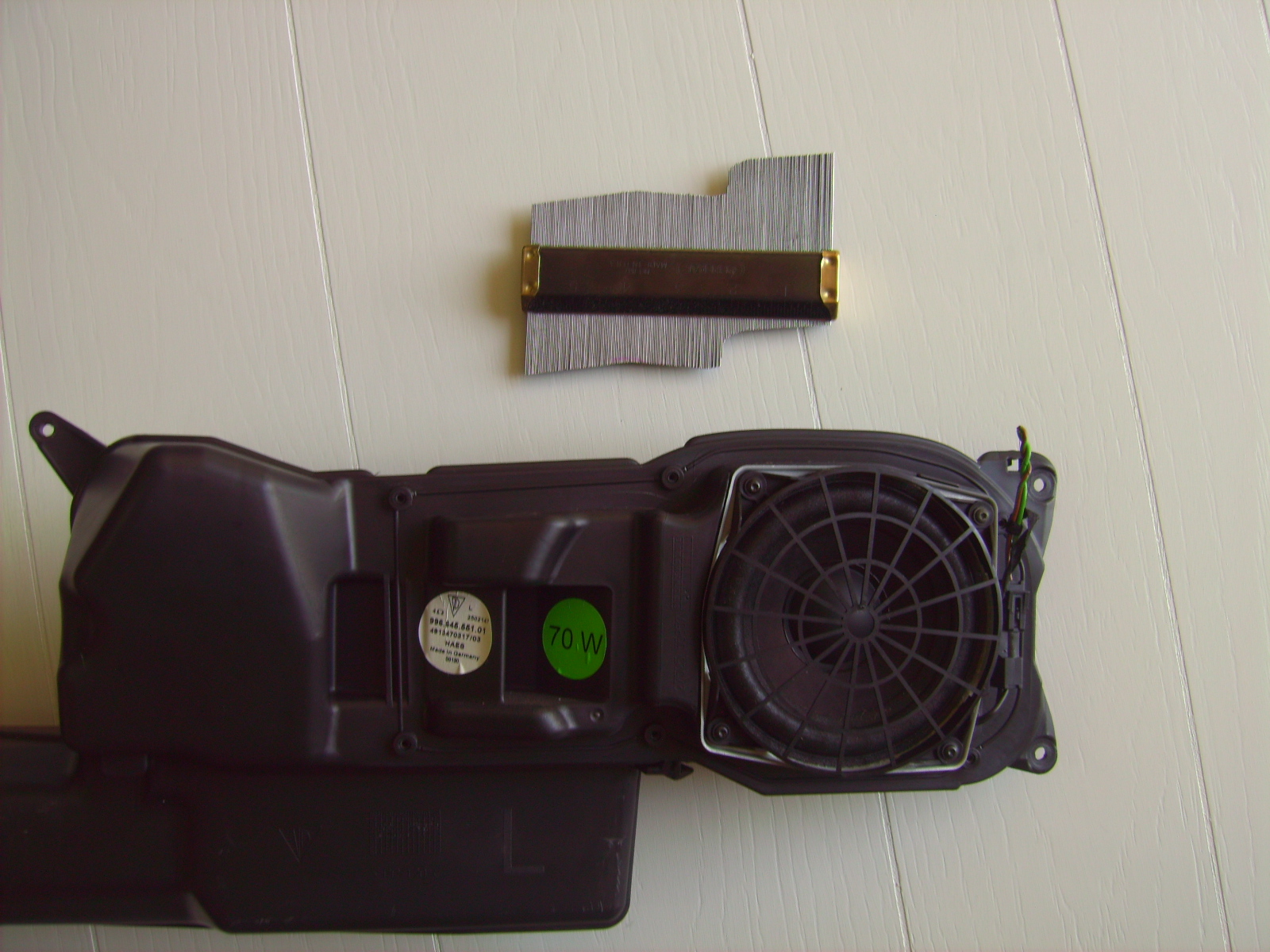

The PIV164 are 6.5". Because of the fitting of the sheets into the door frame there is no room for bigger sizes. The added picture shows the how I measured the sheets. I used a $6 tool from Lowe's that is used to measure edges during lamination etc. but that works great for the door installation too. Maybe I'll do a quick DIY guide (would be my first one ever, but this forum here is it worth!)
